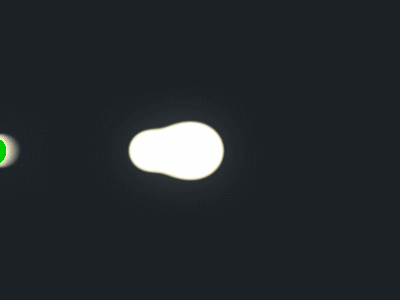

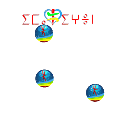

new bootanimation all tested on 480x800 devices
pictures are made by :http://adrar-inu.blogspot.be
download :flower
download :guirlande
download :moving bubbles
download :bounce
download :cube
